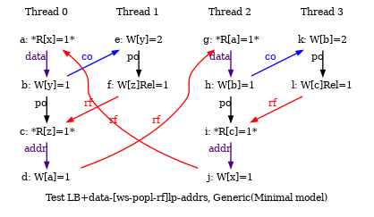

AArch64 LB+data-[ws-popl-rf]lp-addrs
"DpDatadW WsLeave PodWWPL RfBackLP DpAddrdW Rfe DpDatadW WsLeave PodWWPL RfBackLP DpAddrdW Rfe"
Prefetch=0:x=F,0:a=W,1:y=F,1:z=W,2:a=F,2:x=W,3:b=F,3:c=W
Com=Rf Rf Rf Rf
Orig=DpDatadW WsLeave PodWWPL RfBackLP DpAddrdW Rfe DpDatadW WsLeave PodWWPL RfBackLP DpAddrdW Rfe
0:X1=x; 0:X3=y; 0:X5=z; 0:X8=a;
1:X1=y; 1:X3=z;
2:X1=a; 2:X3=b; 2:X5=c; 2:X8=x;
3:X1=b; 3:X3=c;
P0 | P1 | P2 | P3 ;
LDR W0,[X1] | MOV W0,#2 | LDR W0,[X1] | MOV W0,#2 ;
EOR W2,W0,W0 | STR W0,[X1] | EOR W2,W0,W0 | STR W0,[X1] ;
ADD W2,W2,#1 | MOV W2,#1 | ADD W2,W2,#1 | MOV W2,#1 ;
STR W2,[X3] | STLR W2,[X3] | STR W2,[X3] | STLR W2,[X3] ;
LDR W4,[X5] | | LDR W4,[X5] | ;
EOR W6,W4,W4 | | EOR W6,W4,W4 | ;
MOV W7,#1 | | MOV W7,#1 | ;
STR W7,[X8,W6,SXTW] | | STR W7,[X8,W6,SXTW] | ;
exists
(b=2 /\ y=2 /\ 0:X0=1 /\ 0:X4=1 /\ 2:X0=1 /\ 2:X4=1)
